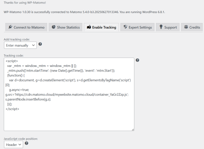

For the Connect Matomo (WP-Matomo) plugin:
- Click on the plugin’s Settings and go to the Enable Tracking tab.
- From the Add tracking code drop-down, choose Enter manually.
- Paste the Tag Manager code snippet (copied in step 1) into the Tracking code block.
- Set the JavaScript code position to Header.
- Save the changes.

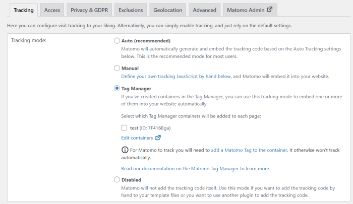

For the Matomo for WordPress plugin:
- Click on the Matomo Analytics menu > Settings.
- For the Tracking mode, choose Tag Manager and select the container used for tracking. If the Tag Manager option is disabled, it means there is no existing container to choose from, so you will need to set up a new container.
- Save the changes.

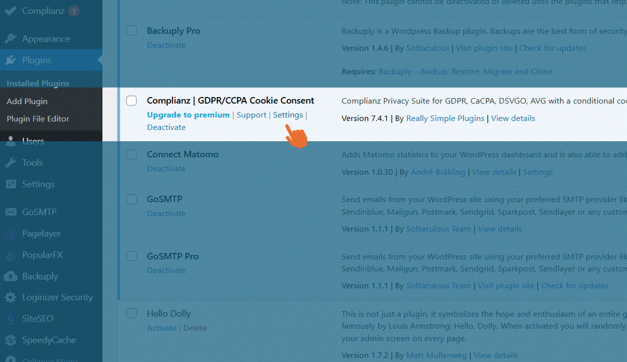

- Once the plugin is installed, navigate to WordPress > Plugins > Installed Plugins.
- Click Settings and then open the Wizard tab.
- Follow each step according to your privacy laws and requirements.

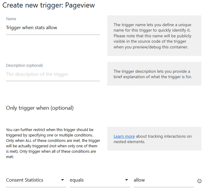

4. Add Pageview Triggers for consent given and consent denied
Two Pageview triggers are needed – one for each consent status: allow and deny. Each trigger requires a condition where the value of the first-party cookie equals the specific consent status. When the condition matches, the trigger fires a Custom HTML tag.
- Navigate to Triggers and click Create New Trigger.
- Choose the Pageview type and provide a user-friendly name.
- Define the condition by selecting your First-party Cookie and choose
equalsallow. - Click Create New Trigger to save.
- Create a second Pageview trigger with the condition where your First-party Cookie
equalsdeny. - Click Create New Trigger to save.
