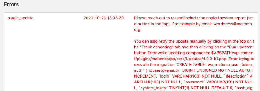

First, check your system report whether it has any plugin_update errors like in the screenshot below. This error would be shown right in the beginning of the system report:
If that’s the case and the same error appears multiple times, please reach out to us and include the copied system report. There is a button at the top of the page to copy an anonymised version of the system report. If you prefer, you can also create an issue on our GitHub issue tracker instead of contacting us.
If such an error is shown, but the same error message isn’t shown multiple times, then the error might eventually go away the next time the updater runs. You could for example manually trigger the update again to see if it fails with the same error message as before (see below for how to trigger a database upgrade manually).
If that’s not the case, it seems like there is no issue and if previously an update error, it fixed itself by retrying the update.
