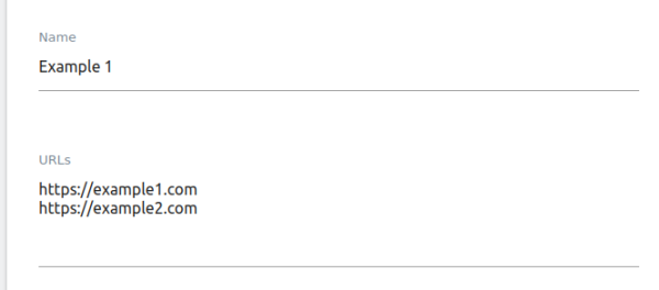

If we take for example the following example websites: example1.com and example2.comIf example2.com is added as a website in example1.com‘s settings in Matomo (See screenshot below) then any clicks on links from example1.com to example2.com won’t be tracked as outlinks:

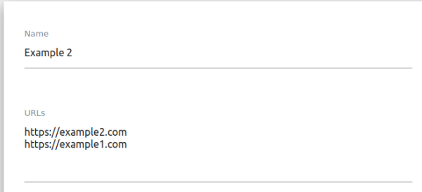

Likewise, if example2.com has example1.com set as a URL for itself, then any links clicked on from example1.com to example2.com won’t be counted as a referrer. For example if your settings for example2.com were as follows:

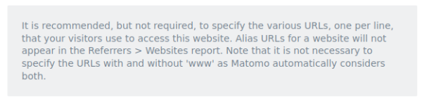

As we can see from the tooltip in the Matomo settings for the websites (Administration > Websites/Measurables > Manage > Edit site), it specifies that any aliases added here will not appear in the Referrers > Websites report:
