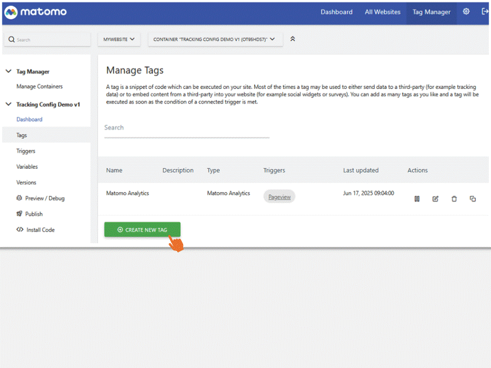

- In Tag Manager, navigate to Tags and click Create New Tag.
- Choose the OneTrust tag.
