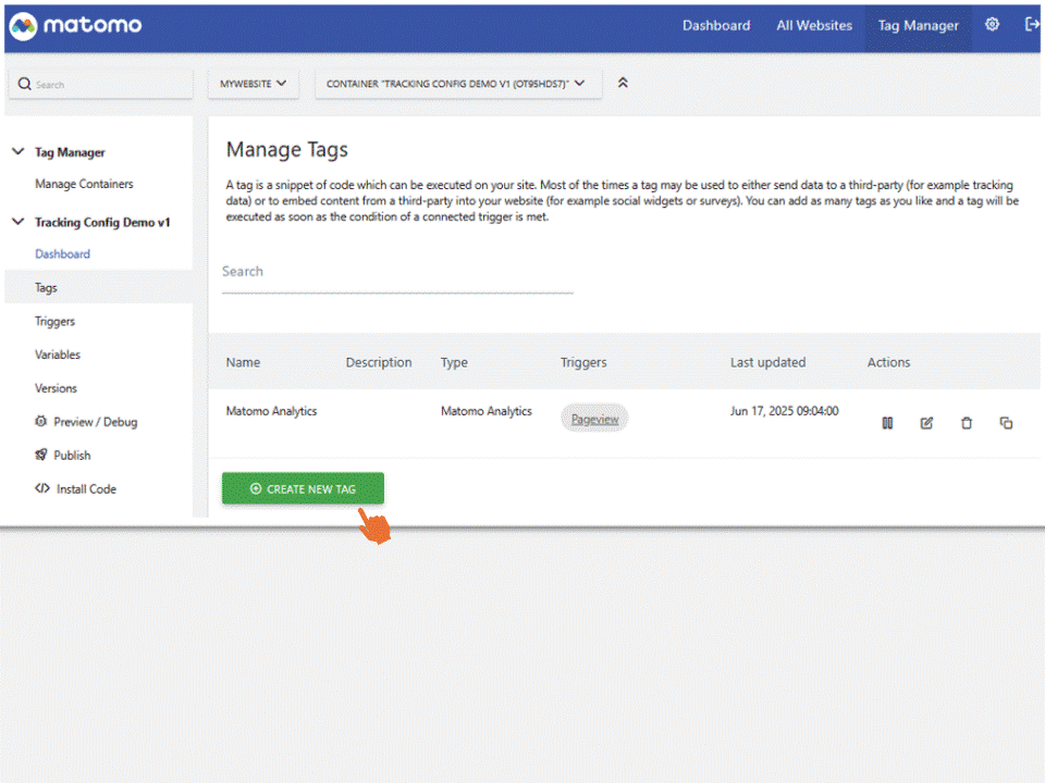

- In Tag Manager, navigate to Tags and click Create New Tag.
- Choose the Axeptio tag.
- Enter your Axeptio Project ID (found in your Axeptio admin account > Integration).
- In the section, Configure when the tag should do this, select a Pageview trigger.
- Click Create New Tag to save the Axeptio tag.
