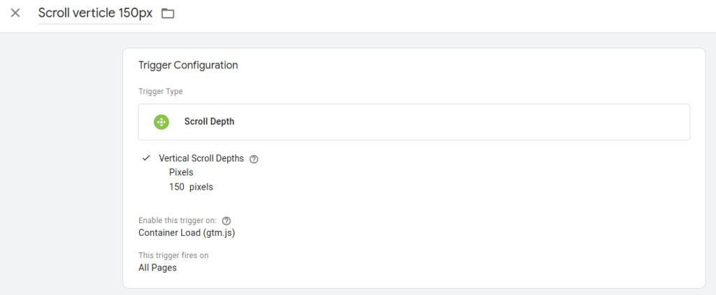

Example 1: Scroll trigger
Say you have a GTM Scroll Depth trigger that looks something like this:
You could create a similar trigger in MTM by doing the following:

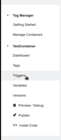

Click on the Triggers option in the left navigation pane:
Click the button to create a new trigger:

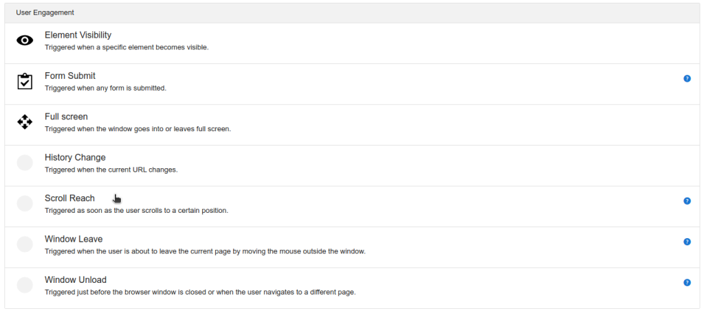

You will be prompted for the trigger type. Select the Srcoll Reach type:
- Give the trigger the same or similar name.

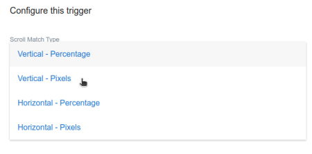

Select the appropriate Scroll Match type:

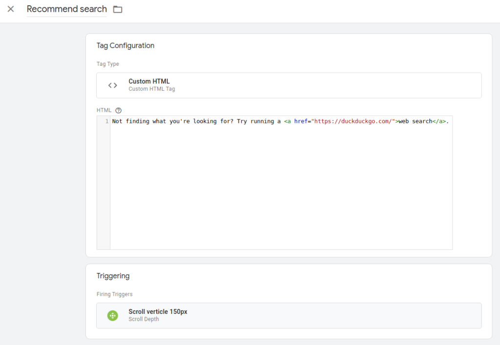

Example 2: Custom HTML variable
Say you have a GTM variable using the previously mentioned trigger to display some text like this:
You could create a similar tag in MTM by doing the following:
Select the Tags option from the left navigation pane.
Click the button to create a new tag.

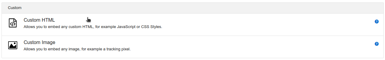

Select the Custom HTML tag type.
Set the name of the tag.
Populate the Custom HTML field with the desired HTML.

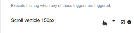

Select the trigger created in the previous example.

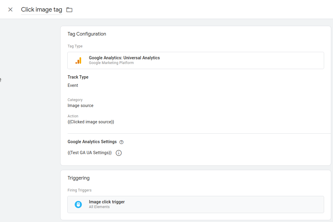

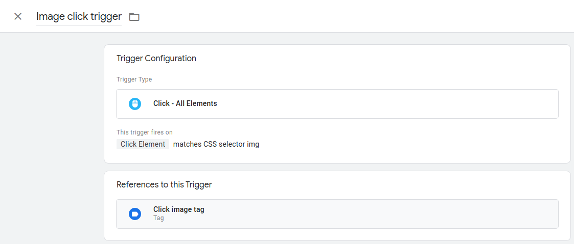

Maybe you have a GTM tag that tracks the source URL of any image that’s clicked on the site. You first have a trigger for image clicks something like this:

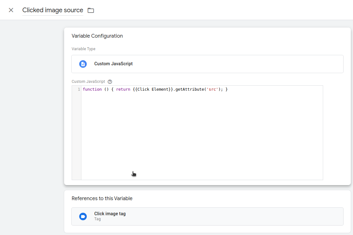

You have a Custom JavaScript variable something like this:

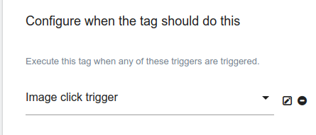

Your tag then references your trigger and variable something like this:

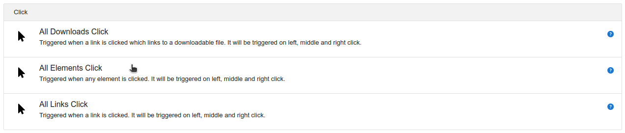

You will be prompted for the trigger type. Select the All Elements Click type:

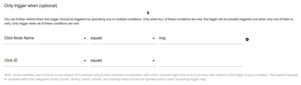

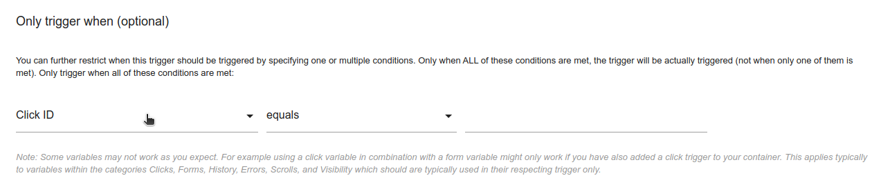

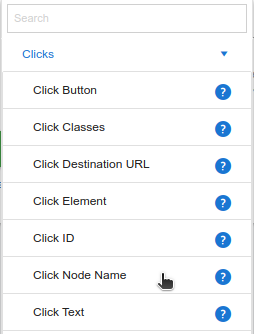

In the Only trigger when (optional) section, click on the select to choose the variable to restrict by:
You can then either expand the Clicks type group or search for ‘Click n’ and select the Click Node Name option:
Leave the operator as equals and set the value as ‘img’ like this:
- Fill out any other desired fields and click the button at the bottom of the form to create the new trigger.

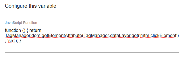

Next, select the Variables option from the left navigation pane:
Set the name of the variable.
Set the value in the JavaScript Function input to the following:
function () { return TagManager.dom.getElementAttribute(TagManager.dataLayer.get('mtm.clickElement'), 'src'); }
If you’d like more information about what this JavaScript is doing, you can look at the Tag Manager JavaScript API documentation. - Fill out any other desired fields and click the button at the bottom of the form to create the new variable.

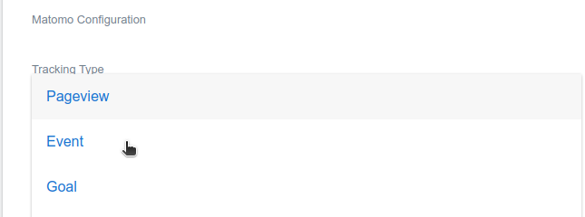

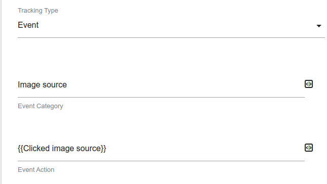

Select Event as the Tracking Type:
Populate the event category and action similar to how they were set in GTM. You can use the button on the side of the action input to select the variable created earlier:
Change the drop down that defaults to Pageview to the trigger created previously:
