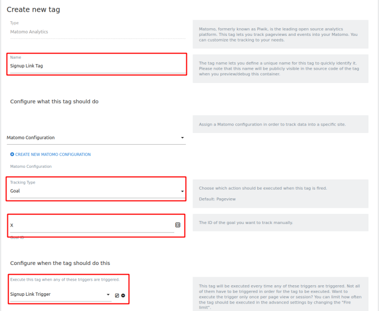

- Create a new « Matomo Analytics » tag with name « Signup Link Tag »
Tracking Type: Goal.
Goal ID: The Goal ID. - Configure the tag the Execute when the « Signup Link Trigger » is triggered
