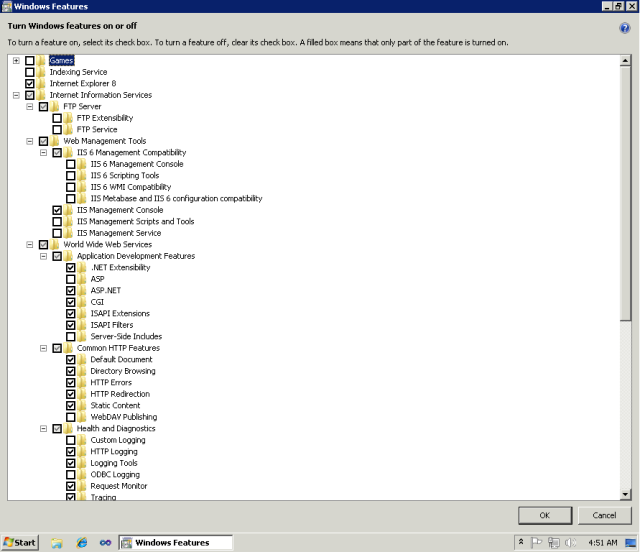

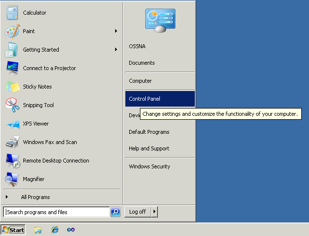

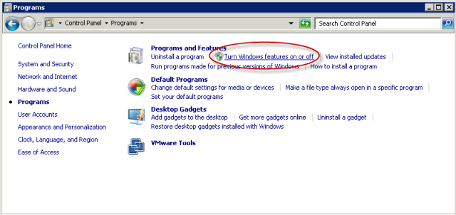

  1. First of all, select the Control Panel.

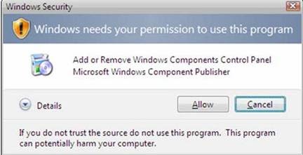

  2. In the Programs section, select Turn Windows Features on or off.
  3. You might encounter the following screen:
  4. Now, simply click on the features that are checked on the following screens and then hit the OK button.

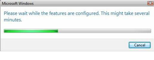

  5. A progress bar will appear.

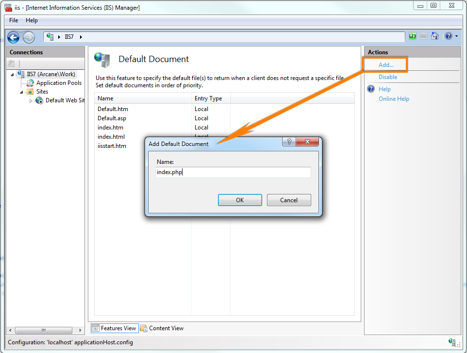

Configure IIS to treat index.php as the default content page
  1. To open IIS Manager, click Start, type iis in the Search Programs and Files box, and then press Enter.
  2. Select and open Default Document at the server level:
  3. Click Add… and enter index.php:

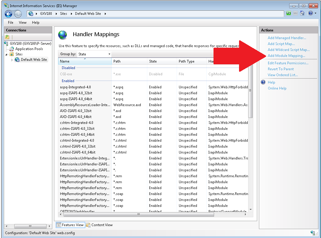

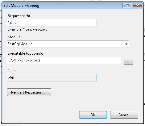

Configure IIS to handle PHP files

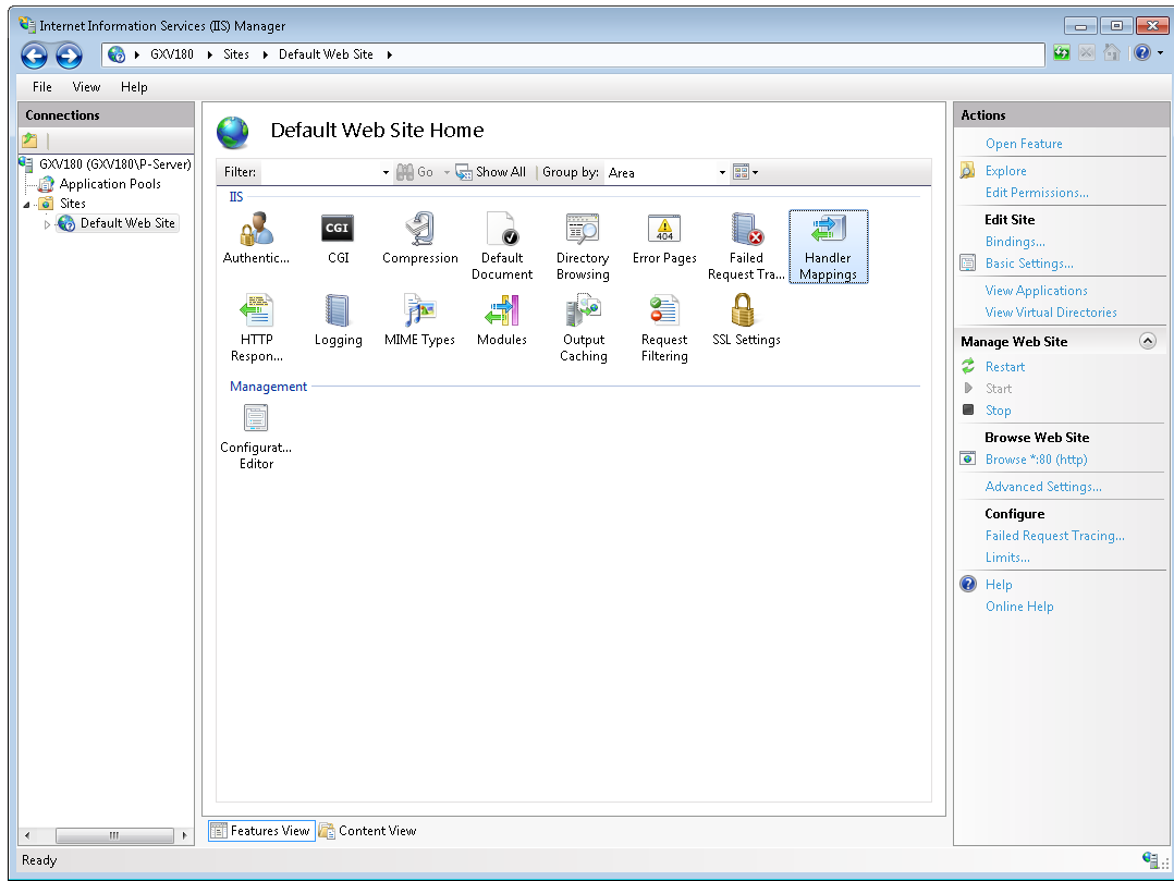

  1. Click Handler mappings:
  2. Click Add Module Mapping from the right hand menu:
  3. Configure the dialog as shown below:
  4. Click OK.
  5. A prompt will ask if you want to add this as a fastCGI application. Select no.

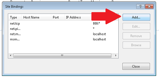

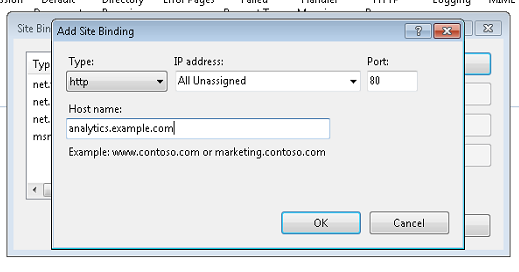

Configure IIS bindings

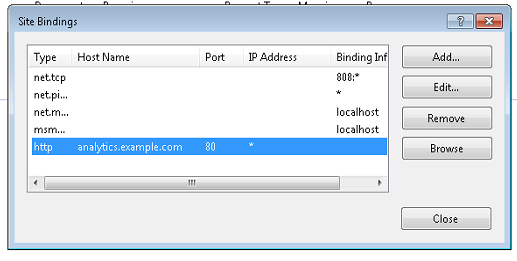

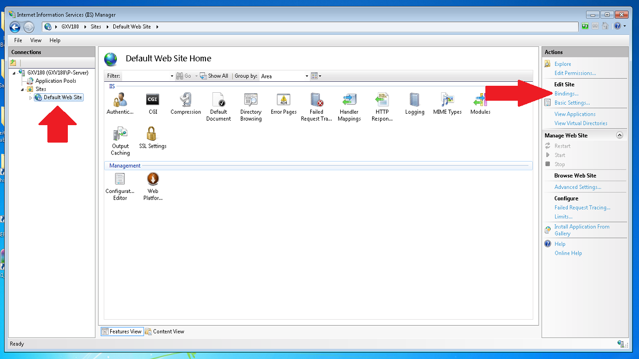

  1. Open IIS Manager and select your website that contains Matomo.
  2. Then select Bindings …
  3. Select Add …
  4. Enter the domain for your Matomo, click OK.
  5. Confirm the binding has been added.
  6. Update your DNS entries to point towards the server.

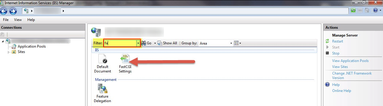

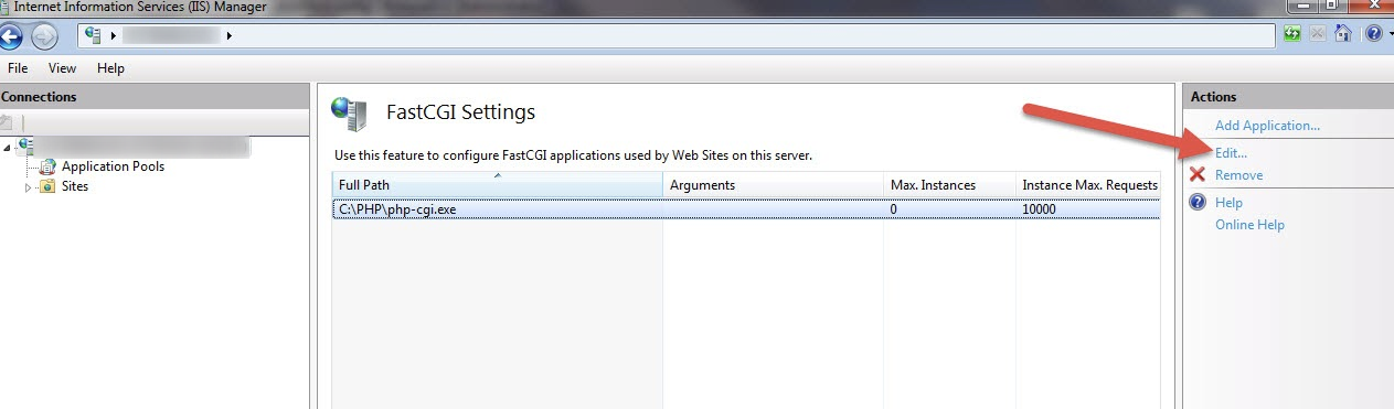

Configure FastCGI timeout for IIS

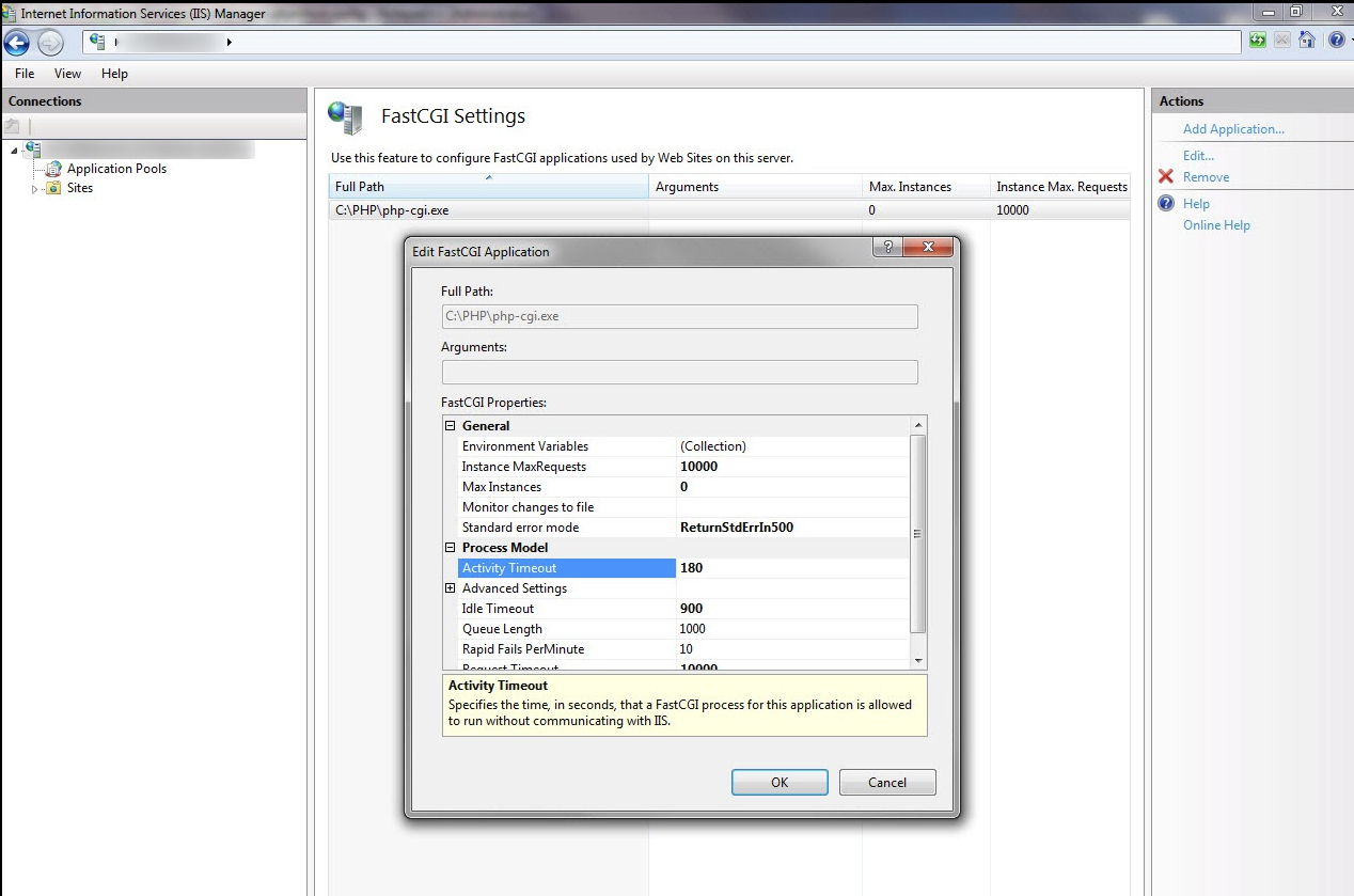

Next we need to change the configured activityTimeout in the IIS Manager under the server/IIS/FastCGI Settings/Edit to a higher value than what is set to by default.
Depending on the amount of data the archiver will need to process, it may be necessary to increase the value to a very high number (such as 36000 or more – which is 10 hours) to allow the archiver to complete.
Not setting this to a higher value will result in the Matomo archiver not being able to process any reports.
Once this has been changed, you will need to restart the server for these changes to take effect.
You can also follow the steps below to change the Activity Timeout setting for example in IIS 7.5:

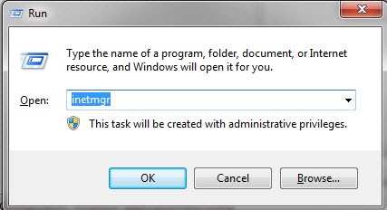

  1. Open InetMgr (Press the windows key+R then type Inetmgr and hit enter)
    open inet manager from run command
  2. Use the filter to search for FastCGI Settings

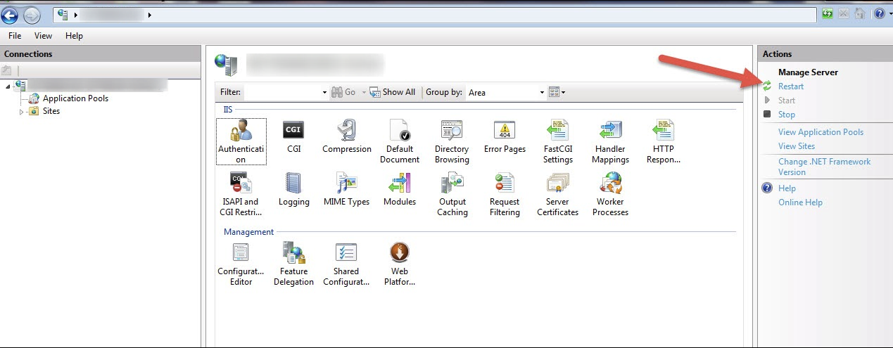

  3. Click on Edit… and proceed to change the Activity Timeout value to 36000 or more.
  4. Once the value has been changed, you will need to restart the server in order for the changes to take effect.
Please note: the steps to change this value may be different depending on which version of IIS you have installed.

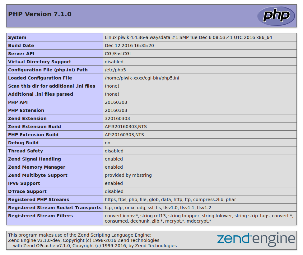

Verify the web server is responding
Create a file in c:\Inetpub\wwwroot called phpinfo.php In order to quickly verify that your web server is correctly configured to execute PHP scripts, you could create a file which contains:
<?php
phpinfo();
When you visit this page at http://127.0.0.1/phpinfo.php you see a similar phpinfo output:
Congratulations, your web server is running and correctly configured to handle PHP7 requests.

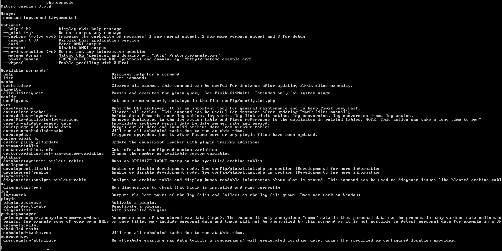

Verify the Matomo console command is working
Next, open a command, and run the Matomo console to check it is working as expected:
php "c:\Inetpub\wwwroot\console"
The console command output will look like this:
