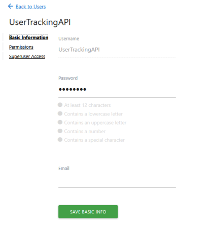

Set up a Matomo user for the tracker proxy
A dedicated Matomo user is required if your tracker proxy authenticates requests when forwarding them to Matomo. In this setup, the proxy uses a token_auth value to authenticate tracking requests server-side. You will need to generate the token_auth in Matomo, then add it to the tracker proxy configuration on your server.
To set up the user and generate a token_auth:
- Log in to Matomo as a superuser.
- Create a new dedicated user, for example, named
UserTrackingAPI.
- Assign this user Write or Admin permission for all websites that will use the tracker proxy.
- Log in as the new user.
- Generate the authentication token and store it securely. The
token_authmust not be restricted to secure (POST-only) requests. It is only used server-side by the proxy to authenticate tracking requests sent to Matomo and it is never exposed to the browser. If the proxy cannot reach Matomo Cloud, authentication does not occur and the proxy will silently fail.

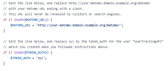

Configure the proxy to forward requests
- Open the
proxy.phpfile and edit the configuration variables. - Set
$MATOMO_URLto your Matomo instance URL, and - The
$TOKEN_AUTHmust contain thetoken_authgenerated for the dedicated Matomo user.
- Upload all proxy files to your web server so they are accessible at the URL you intend to use for tracking.

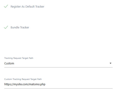

Define the tracking endpoint in Tag Manager
Matomo Tag Manager does not automatically use the proxy. You need to configure the tracking endpoint in the Matomo Configuration Variable used by your tags.
- In Tag Manager, go to Variables.
- Open the Matomo Configuration Variable used by your tags.
- Locate the setting, Tracking Request Target Path.
- Provide the proxy endpoint, for example
https://mysite.com/matomo.php, or if the proxy is in a subdirectory /matomo/matomo.php.
- Save the variable and publish the container.
This ensures that all Matomo Analytics tags send data through the proxy.
