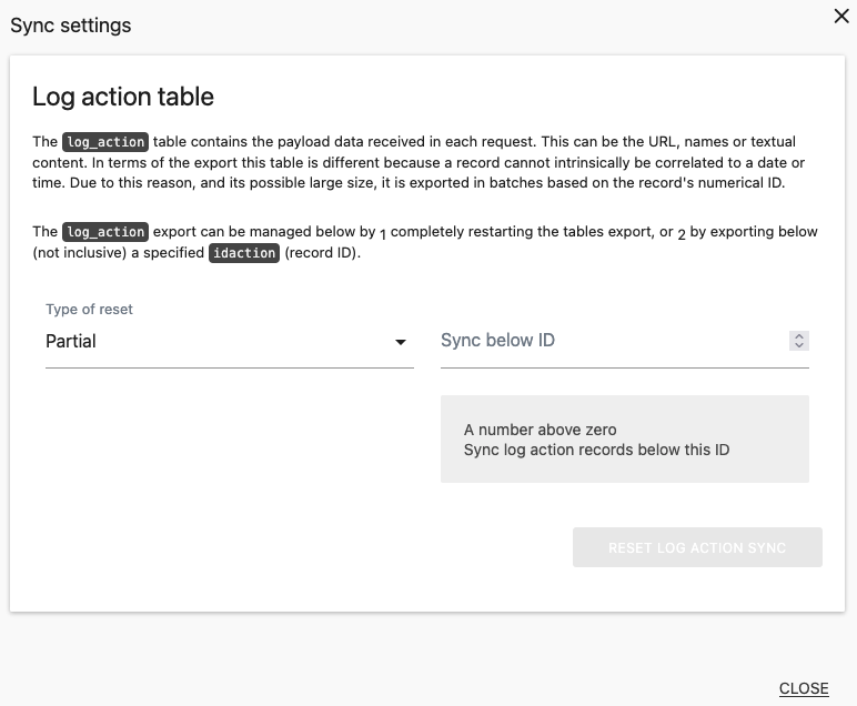

Reset options for the log_action table export
- Go to Administration
> Export > Data Warehouse Connector. - Click on Sync Settings.
- Full Reset:
- To re-export the entire log_action table, set the Type of reset as Full.
- Click Reset Log Action Sync.
- On the next sync (depending on batch size), the
log_actiontable will be re-exported from the minimumidactionto the maximum ID currently in the table.
- Partial Reset:
- To export only a subset of the
log_actiontable: set the Type of reset as Partial. - Provide an
idactionvalue as the upper limit. - On the next sync, the
log_actiontable will be exported from the minimum ID available in the database up to (but not including) the specifiedidaction.
Important Notes
- You can only trigger a reset after a full sync of
log_actionhas completed. - If a sync is still in progress and you attempt a reset, an error message will indicate that a sync is still underway.
- If no export metadata exists for the
log_actiontable i.e. no previous export has been started or completed, attempting a reset will result in an error message explaining the current state.
