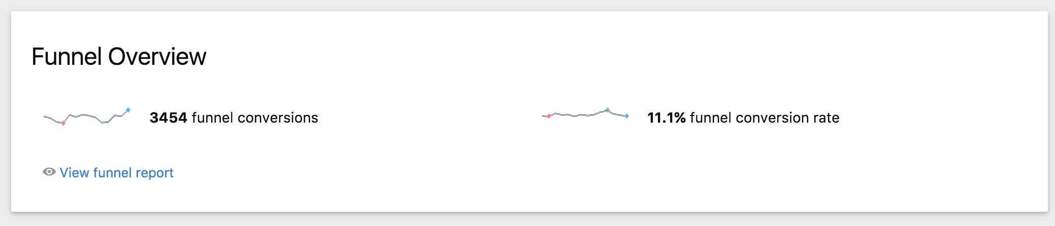

Integration in Goal reports

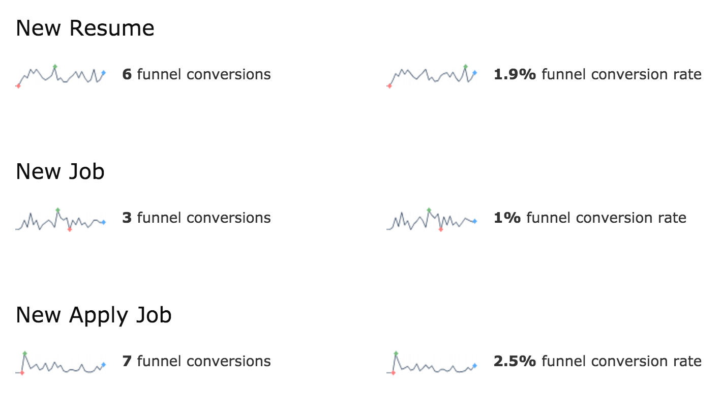

At Matomo and InnoCraft, we usually start looking into our goal reports. Funnel integrates directly into each goal reporting page giving you a quick overview how your funnel is doing. This saves us a lot of time as we don’t have to separately look into each funnel page and only takes us maybe an additional second to keep an eye on our funnels. By clicking on the headline or “View funnel report” link, you can directly go to the funnel report to get a more detailed report if you notice any spike in the evolution of the conversions or conversion rate.

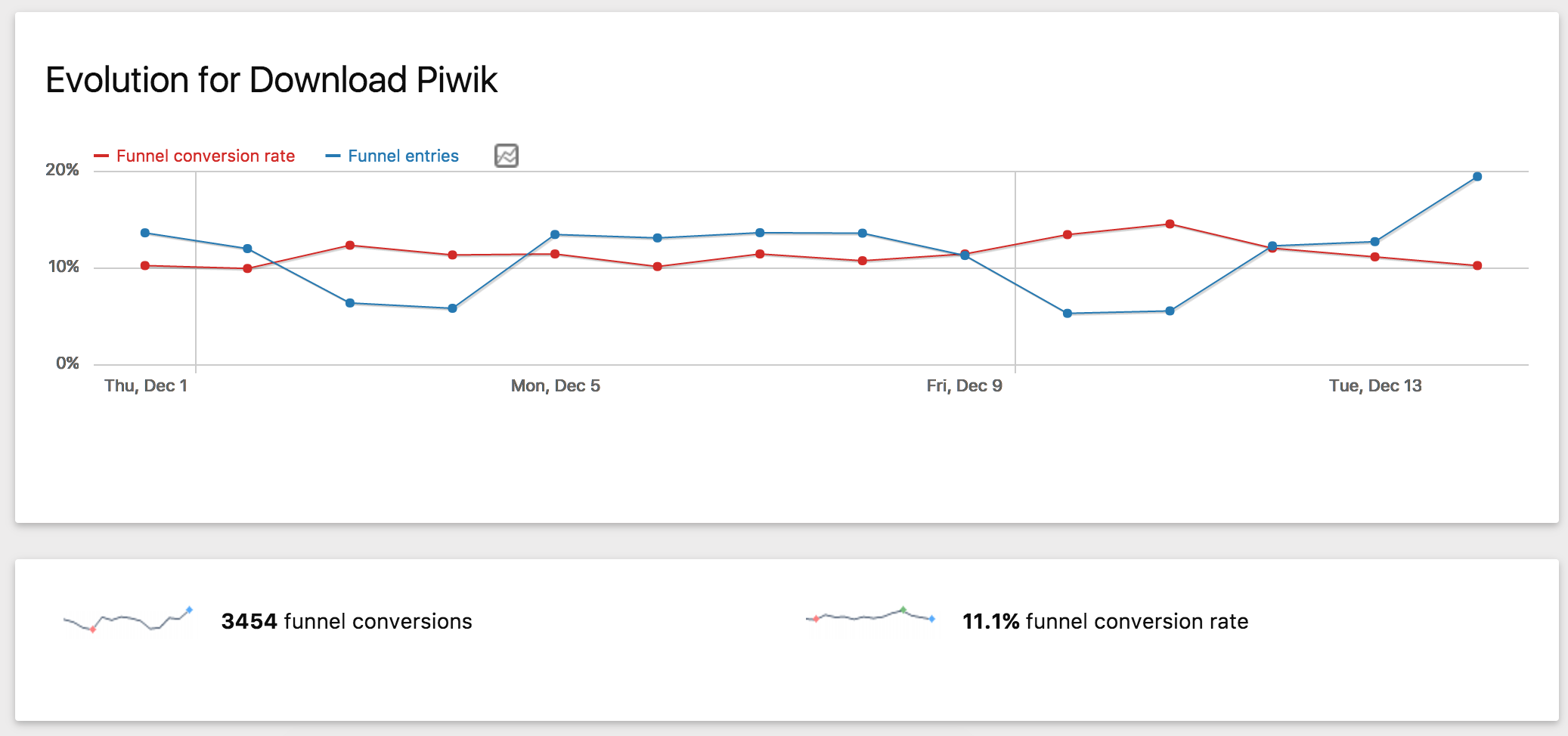

A funnel reporting page looks very similar to a Goal reporting page. It starts with an evolution graph and sparklines showing you the performance of your funnel over time.

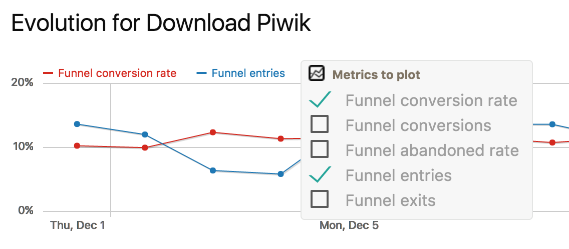

In the evolution graph you can select the metrics you want to plot. We usually have an eye on the funnel conversion rate and the number of “Funnel entries” or the number of “Funnel conversions”. The conversion rate alone does not show you how your funnel is performing. Imagine the rate is always stable at around 20% and you might think everything is alright, but if the number of visitors that take part in your funnel goes down, you might have a problem as the number of funnel conversions actually decreases even though the rate is the same. So we recommend to not only have a look at the conversion rate. The report will remember the metrics you want to plot each time you open it so you don’t have to re-select them over and over again.

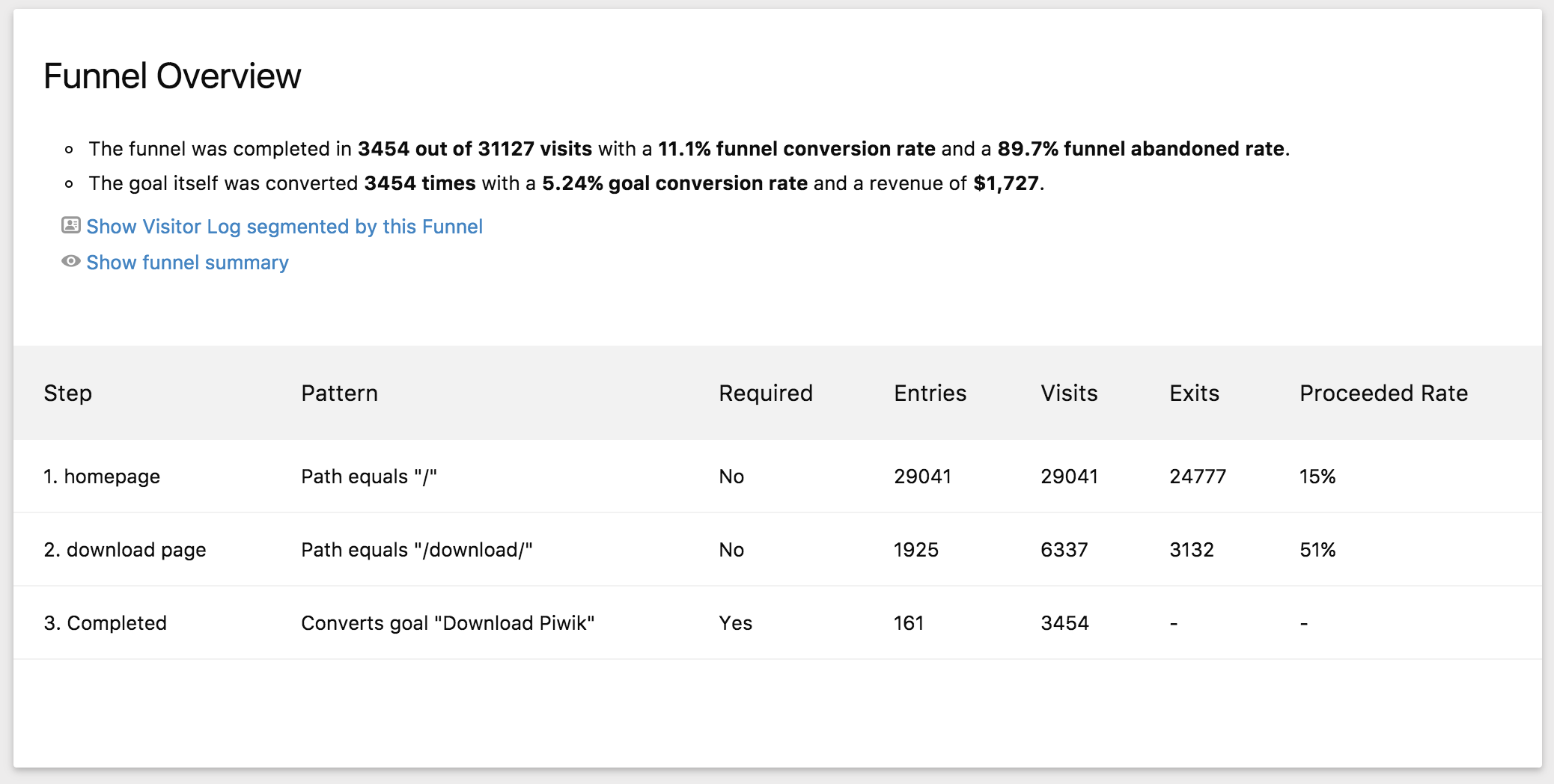

The funnel overview
In the funnel overview we are giving you more details about the funnel and goal related conversion metrics so you don’t have to switch between the goal and funnel report and compare them easily.
When you analyze a funnel report, you might not always remember how the funnel is configured. Even though you specify names for each step you sometimes need to know on which pages a certain step will be activated. By clicking on the funnel summary link you can quickly look into the funnel configuration and also see all important metrics at a glance in a simple table without having to scroll.

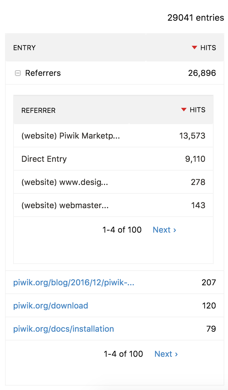

Most tools only give you the pages where visitors have entered your funnel but we do better and also show you the list of external referrers used by visitors to enter your funnel directly (marketing campaigns, search engines or other websites). Also we do not only show only the top 5 pages but up to 100 pages and 50 referrers (more can be configured if needed). When you hover a row, you will not only see the number of hits but also the percentage each row has contributed to the entries. Here you want to look and understand how your visitors enter your funnel and based on the data maybe invest in successful referrers, campaigns and pages. If the pages or referrers you expect to see there don’t show up, your users might not understand the path you had in mind for them.

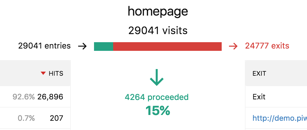

Next you may notice how many visits have gone through each step, in this case 3487 visits. The green and red bar lets you quickly identify how many of your visitors have proceeded to the next step (green) compared to how many have exited the funnel at this step (red). Ideally, most of the bar is green and not red indicating that more visitors proceed to the next step than they exit.

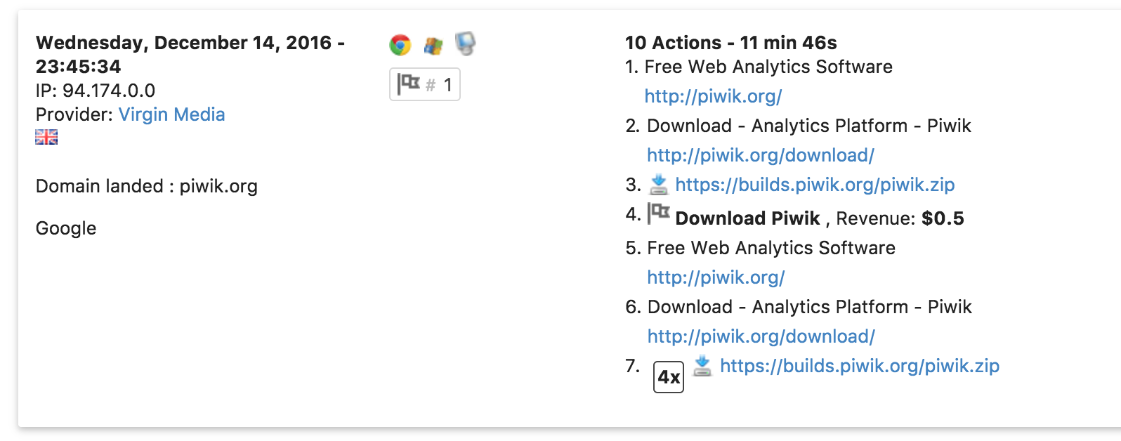

Those two little icons are really powerful and give you even more insights to really dig into all the data. The left icon shows you the visitor log showing all actions of each visitor that have participated in this particular funnel step. This means for each step you get to see all the details and actions of each visitor. This lets you really debug and understand problems in your funnel.

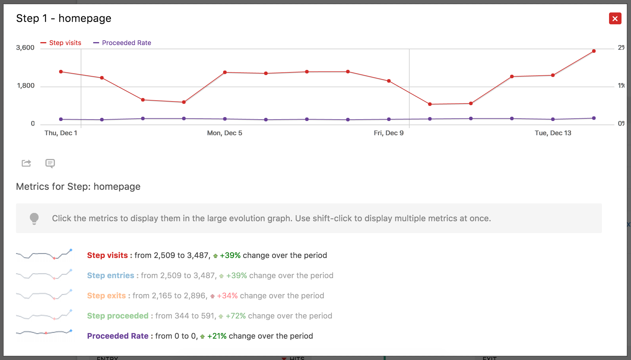

At InnoCraft, we understand that plain numbers are often not so valuable. Only the evolution over time, when you put the numbers in relation to something else you can really understand how your website is doing. The icon to the right lets you do exactly this, it lets you view the row evolution for each funnel step. We are sure you will enjoy this feature. It lets you explore how each funnel step is doing over time. For example the number of entries for a step or how many proceeded to the next step from here over time. Here you ideally want to see that the “Proceeded Rate” increases over time, meaning more and more visitors actually proceed to the next step instead of exiting it.

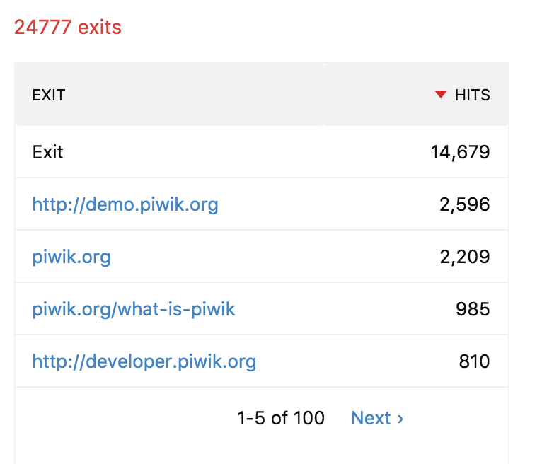

On the right you can find out where your visitors went to, if they did not proceed any further in the funnel. This lets you better understand why they left the funnel and did not proceed any further.

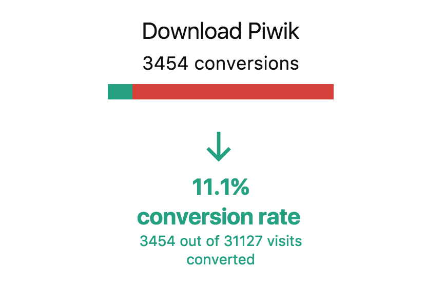

At the end of the funnel report you find again the number of conversions and the conversion rate. Here we recommend looking into the visitor log when you hover the name of the last step as you can analyze how each visitor converted this funnel in detail.
